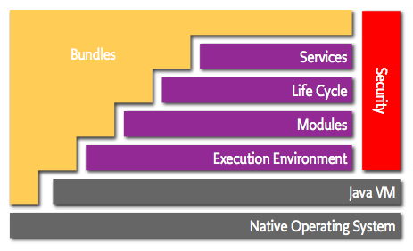

The OSGi framework consist of several layers build on top of each other (See Fig. 1):
- Module Layer - it is responsible for managing dependencies between bundles and for class loading (See Bundles Section);
- Life Cycle Layer - controls the lifecycle of the bundles (See Lifecycle Section);
- Service Layer - defines a dynamic model (publish/find/bind) of communication between different modules (See Services Section);
- Actual Services (Bundles on Fig.1) - this is the application layer, using all other layers;
- Security Layer - optional layer, based on the Java 2 security architecture, that manages permissions for different modules.
Fig.1 OSGi Layering (Source:https://www.osgi.org/wp-content/uploads/layering-osgi.png (opens new window))
More details about the OSGi architecture can be found at https://www.osgi.org/developer/architecture/ (opens new window)
