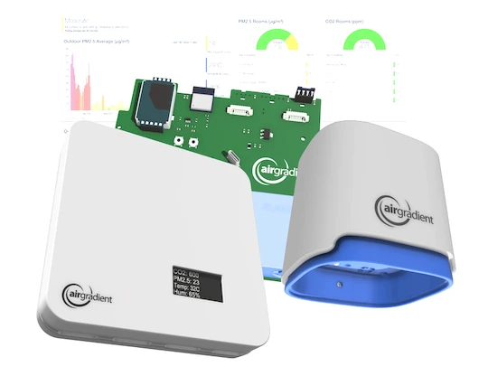

# AirGradient Binding
AirGradient provides open source and open hardware air quality monitors.
This binding reads air quality data from the AirGradient (https://www.airgradient.com/ (opens new window)) API.
This API is documented at https://api.airgradient.com/public/docs/api/v1/ (opens new window)
# Supported Things
This binding supports all the different AirGradient sensors, providing most of the sensor data.
