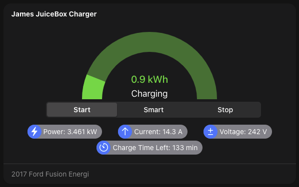

# Widget
The following custom widget can be used with this binding.
uid: widget_JuiceBox
tags: []
props:
parameters:
- description: Prefix for the items with the data
label: Item prefix
required: false
type: TEXT
parameterGroups: []
timestamp: May 10, 2021, 2:38:55 PM
component: f7-card
title: =items[props.prefix + "_Name"].state
style:
--f7-card-header-border-color: none
default:
- component: f7-card-content
default:
- component: f7-row
class:
- display-flex
- align-content-stretch
- align-items-center
default:
- component: f7-gauge
type: semicircle
value: =Number.parseFloat(items[props.prefix + "_CurrentEnergy"].state) / Number.parseFloat(items[props.prefix + "_CarBatteryPackSize"].state)
bg-color: transparent
border-bg-color: '=(items[props.prefix + "_DeviceState"].state === "charging") ? "#577543" : (items[props.prefix + "_DeviceState"].state === "plugged") ? "#8f6c2f" : "#595959"'
border-color: '=(items[props.prefix + "_DeviceState"].state === "charging") ? "#90d164" : (items[props.prefix + "_DeviceState"].state === "plugged") ? "#ed9c11" : "#adadad"'
borderWidth: 40
value-text: =items[props.prefix + "_CurrentEnergy"].displayState
value-text-color: '=(items[props.prefix + "_DeviceState"].state === "charging") ? "#90d164" : (items[props.prefix + "_DeviceState"].state === "plugged") ? "#ed9c11" : "#adadad"'
value-font-size: 20
value-font-weight: 500
label-text: =items[props.prefix + "_DeviceState"].displayState
label-text-color: white
label-font-size: 18
label-font-weight: 400
noBorder: true
outline: true
- component: f7-row
class:
- display-flex
- justify-content-center
- margin-left
default:
- component: f7-segmented
strong: true
style:
width: 80%
default:
- component: oh-button
text: Start
color: blue
active: =(items[props.prefix + "_ChargingState"].state === "start")
action: command
actionItem: =props.prefix + "_ChargingState"
actionCommand: start
text: Smart
color: blue
active: =(items[props.prefix + "_ChargingState"].state === 'smart')
action: command
actionCommand: smart
text: Stop
color: blue
active: =(items[props.prefix + "_ChargingState"].state === "stop")
action: command
actionCommand: stop
- component: f7-row
class:
- display-flex
- justify-content-space-evenly
- height: 40px
style:
--f7-chip-font-size: 14px
--f7-chip-height: 28px
padding-top: 12px
default:
- component: f7-chip
visible: =(items[props.prefix + "_DeviceState"].state === "charging")
text: '="Power: " + items[props.prefix + "_ChargingPower"].state'
iconF7: bolt_fill
media-bg-color: blue
bg-color: gray
label: hello
style:
padding-rightc: 12px
text: '="Current: " + items[props.prefix + "_Current"].state'
iconF7: arrow_up_circl
bg-color: gray
text: '="Voltage: " + items[props.prefix + "_Voltage"].state'
iconF7: plusminus
bg-color: gray
visible: =(items[props.prefix + "_ChargingState"].state === 'smart')
text: '="Charge at: " + items[props.prefix + "_TargetTime"].displayState'
iconF7: clock
bg-color: gray
visible: =(items[props.prefix + "_DeviceState"].state === 'charging')
text: '="Charge Time Left: " + items[props.prefix + "_ChargingTimeLeft"].displayState'
iconF7: timer
bg-color: gray
- component: f7-card-footer
default:
- component: Label
text: =items[props.prefix + "_CarDescription"].state
