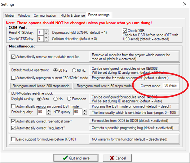

ATTENTION: You must set the correct dimmer output resolution in the PCK Gateway Thing (
mode)! This setting is crucial, and valid for the whole LCN bus.
It is either 0-50 steps or 0-200 steps. It has to be the same as in the parameterizing software LCN-PRO under Options/Settings/Expert Settings.
When using a wrong dimmer output setting, dimming the outputs will result in unintended behavior!
Please see the following LCN-PRO screenshot to determine the dimmer output resolution for the LCN bus:

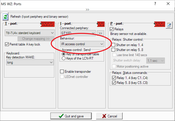

# Transponder/Fingerprints
LCN transponder readers or fingerprint readers can be integrated in openHAB e.g. for access control. The transponder function must be enabled in the module's I-port properties within LCN-PRO.
Example: When the transponder card with the ID "12ABCD" is seen by the reader connected to LCN module "S000M011", the item "M10_Relay7" is switched on:

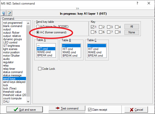

# Command from an LCN Module to openHAB
LCN modules can send commands to openHAB, e.g. by pressing a physical LCN key. The command must be programmed into the LCN module by the programming software LCN-PRO. Only the send keys command (German: "Sende Tasten") is supported.
Program a command to a key of an LCN module via LCN-PRO. When LCN-PRO asks you for the target address, don't select any module, but manually enter the PCK host ID, configured within PCHK (default: 4). Select the send keys command and "A-C (former command)", as PCHK 3.2.2 only supports the old command. Then, select any key(s) you want to send to openHAB. These can be freely chosen, as they are only evaluated by openHAB.
The following rule can be used to trigger any action:
rule "Module 12 sent A1 Hit"
Channel "lcn:module:b827ebfea4bb:S000M012:hostcommand#sendKeys" triggered "A1:HIT"
M10_Relay7.sendCommand(ON)
A1 is the key of the send keys command, programmed by LCN-PRO.
After the colon, the LCN "hit type" follows: HIT, MAKE or BREAK (German: kurz, lang, los)
If multiple keys or key tables are programmed in a single "send keys" command, multiple triggers will be executed.
Notice: Don't test the command with the "Test command" button in LCN-PRO. This will send a command from LCN-PRO to openHAB, but openHAB expects the module as the sender. Simply press the physical button at the module for testing.
# Remote Control
To evaluate commands from LCN remote controls (e.g. LCN-RT or LCN-RT16), the module's I-port behavior must be configured as "IR access control" within LCN-PRO:

# Remote Control used as Access Control
The serial number of a remote control can be used for access control via the channel lcn:module:<pckThing>:<moduleThing>:code#remotecontrolcode. See the following example:
rule "Remote Control Key 3 on Layer 1 hit (only executed for serial number AB1234)"
Channel "lcn:module:b827ebfea4bb:S000M012:code#remotecontrolcode" triggered "AB1234:A3:HIT" or
Channel "lcn:module:b827ebfea4bb:S000M012:code#remotecontrolcode" triggered "AB1234:A3:MAKE"
The command will be executed when the remote control button A3 is either pressed short or long.

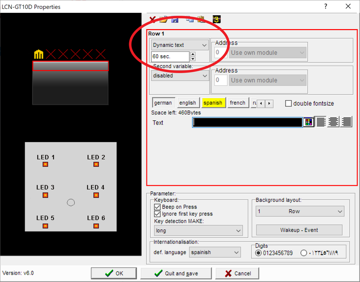

# Dynamic Text
This Action can be used to send custom texts to an LCN-GTxD display. To make this function work, the row of the display has to be configured to allow dynamic text within LCN-PRO:
When programming a "Dynamic Text" Action, the following parameters need to be set:
row - The number of the row in the display: 1-4
text - The text to be displayed (UTF-8)
The length of the text may not exceed 60 bytes of characters. Bear in mind that unicode characters can take more than one byte (e.g. umlauts (äöü) take two bytes).
rule "Send dynamic Text to GT10D hourly"
Time cron "0 0 * * * ?"
val actions = getActions("lcn","lcn:module:b827ebfea4bb:S000M012")
actions.sendDynamicText(1, "Test 123 CO₂ öäü߀") // row 1
