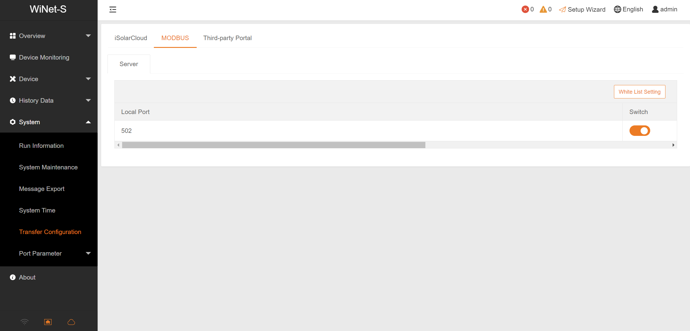

# Preparation
The data from the inverter is read via Modbus. So you need to configure a Modbus Serial Slave serial or Modbus TCP Slave tcp as bridge first.
If you are using a Modbus TCP Slave and the WiNet-S Communication Module please ensure:
- that you have the correct IP-Address of your WiNet-S Device
- that Modbus is enabled within the Communication Module
- that you've the correct port number
- that the white list is disabled or your openHAB instance IP is listed
Enabling modbus and whitelist setting can be done in WiNet-S Web-UI as shown below:
