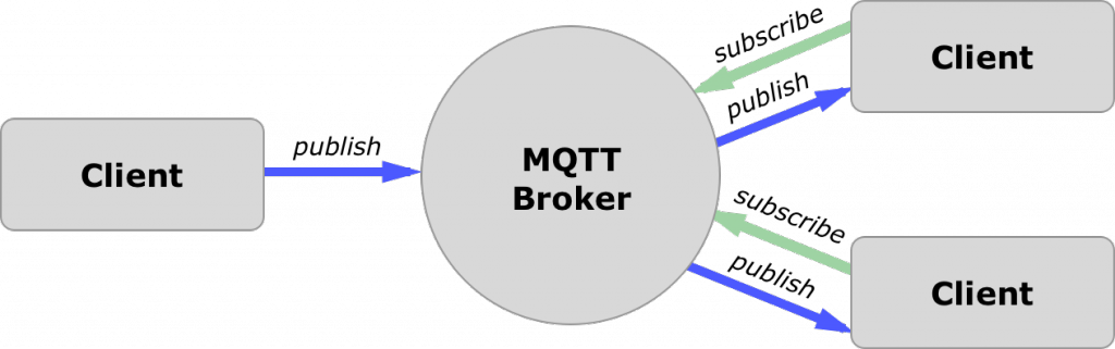

It is designed as a lightweight messaging protocol that uses publish/subscribe operations to exchange data between clients and the server.
MQTT servers are called brokers and the clients are simply the connected devices.
- When a device (a client) wants to send data to the broker, we call this operation a “publish”.
- When a device (a client) wants to receive data from the broker, we call this operation a “subscribe”.
openHAB itself is not an MQTT Broker and needs to connect to one as a regular client. Therefore you must have configured a Broker Thing first via the MQTT Broker Binding!
