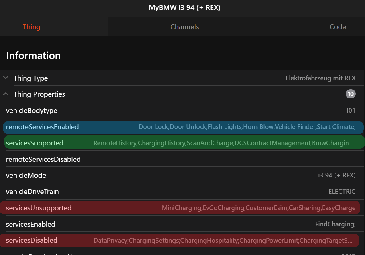

# Properties
For each vehicle properties are available. Basic information is given regarding
  • Vehicle properties like model type, drive train and construction year
  • Which services are available / not available
In the right picture can see in remoteServicesEnabled e.g. the Door Lock and Door Unlock services are mentioned. This ensures channel group Remote Services is supporting door lock and unlock remote control.
In Services Supported the entry ChargingHistory is mentioned. So it's valid to connect channel group Charge Sessions in order to display your last charging sessions.
Property Key Property Value Supported Channel Groups
servicesSupported ChargingHistory session
remoteServicesEnabled list of services remote

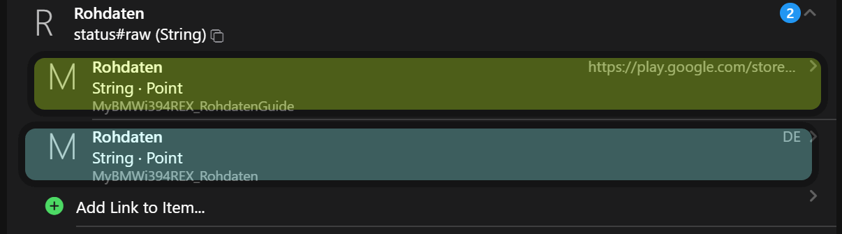

# Vehicle Status Raw Data
The raw data channel is marked as advanced and isn't shown by default. Target are advanced users to derive even more data out of BMW API replies. As the replies are formatted as JSON use the JsonPath Transformation Service (opens new window) to extract data for an item,
Channel ID Type Description
raw String Unfiltered JSON String of vehicle data
Examples:
# Country ISO Code
$.properties.originCountryISO
# Drivers Guide URL
$.driverGuideInfo.androidStoreUrl

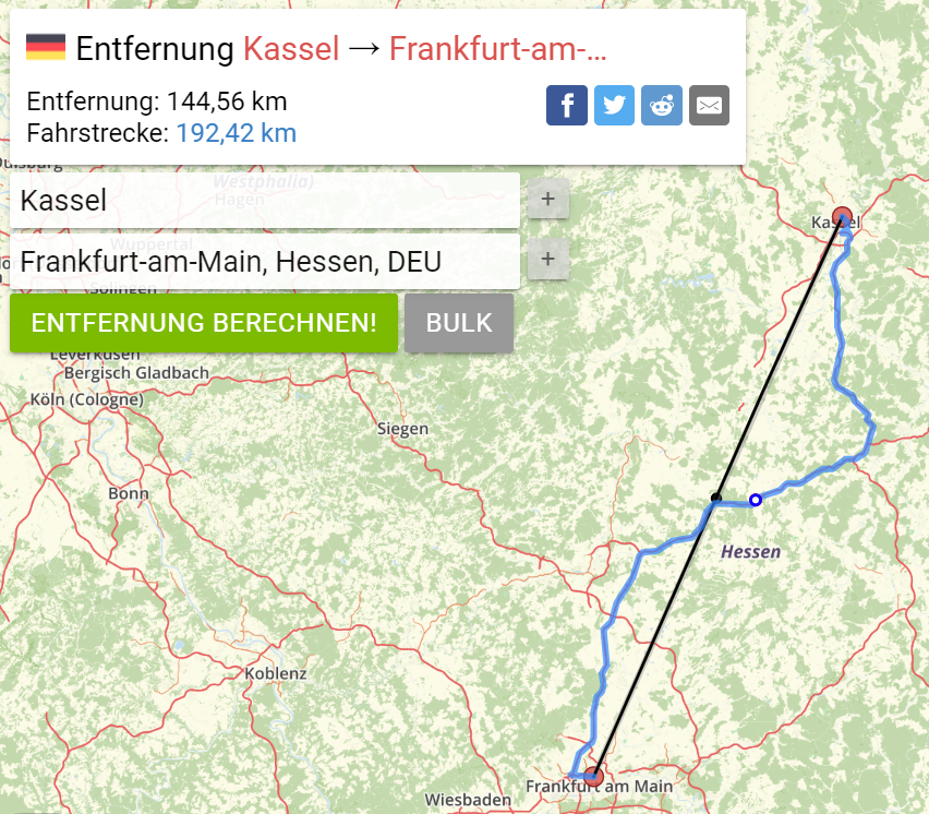

# Range Data
Based on vehicle type some channels are present or not. Conventional fuel vehicles don't provide Electric Range and battery electric vehicles don't show Fuel Range. Hybrid vehicles have both and in addition Hybrid Range. See description Range vs Range Radius to get more information.
  • Channel Group ID is range
  • Availability according to table
  • Read-only values
Channel ID Type Description conv phev bev_rex bev
mileage Number:Length Current mileage of the vehicle X X X X
range-fuel Number:Length Fuel range X X X
range-electric Number:Length Electric range X X X
range-hybrid Number:Length Combined hybrid range X X
soc Number:Dimensionless State of charge X X X
remaining-fuel Number:Volume Remaining fuel in l X X X
estimated-fuel-l-100km Number Estimated fuel consumption in l X X X
estimated-fuel-mpg Number Estimated fuel consumption in mpg X X X
range-radius-fuel Number:Length The calculated range radius combustion X X X
range-radius-electric Number:Length The calculated range radius electric X X X
range-radius-hybrid Number:Length The calculated range radius hybrid combined X X

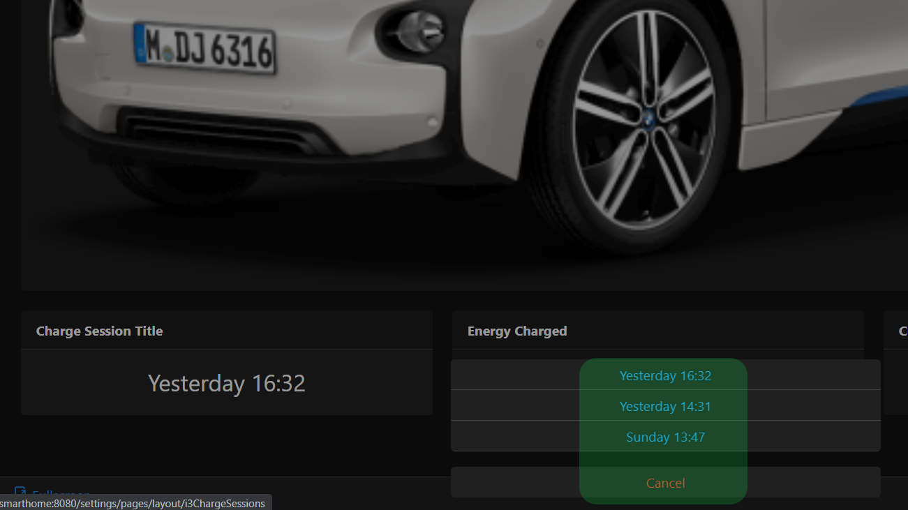

There are 3 occurrences of dynamic data delivered
The channel id name shows the first element as default. All other possibilities are attached as options. The picture on the right shows the Session Title item and 3 possible options. Select the desired service and the corresponding Charge Session with Energy Charged, Session Status and Session Issues will be shown.

# Range vs Range Radius
You will observe differences in the vehicle range and range radius values. While range is indicating the possible distance to be driven on roads the range radius indicates the reachable range on the map.
The right picture shows the distance between Kassel and Frankfurt in Germany. While the air-line distance is 145 kilometers the route distance is 192 kilometers. So range value is the normal remaining range while the range radius values can be used e.g. on Mapview (opens new window) to indicate the reachable range on map. Please note this is just an indicator of the effective range. Especially for electric vehicles it depends on many factors like driving style and usage of electric consumers.
