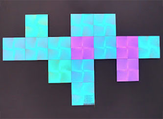

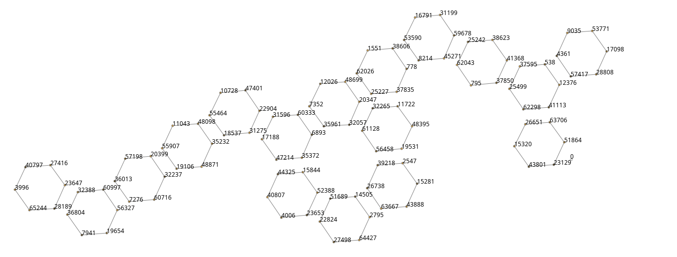

# Panel Layout
If you want to program individual panels, it can be hard to figure out which panel has which ID. To make this easier, there is Layout channel on the Nanoleaf controller thing in openHAB. The easiest way to visualize the layout of the individual panels is to open the controller thing in the openHAB UI, go to Channels and add a new item to the Layout channel. Clicking on that image or adding it to a dashboard will show a picture of your canvas with the individual thing ID in the picture.
If your canvas has elements we dont know how to draw a layout for yet, please reach out, and we will ask for some information and will try to add support for your elements.
There is an alternative method for canvas that use square panels, you can request the layout through a console command (opens new window):
then issue the following command:
openhab:nanoleaf layout [<thingUID>]
The thingUID is an optional parameter. If it is not provided, the command loops through all Nanoleaf controller things it can find and prints the layout for each of them.
Compare the following output with the right picture at the beginning of the article
            31413                    9162       13276
55836       56093       48111       38724       17870        5164       64279
                        58086        8134                   39755
                                    41451
As mentioned above this only works for the squared panels. It is recommended to instead use the layout-channel described below which works for all designs.
