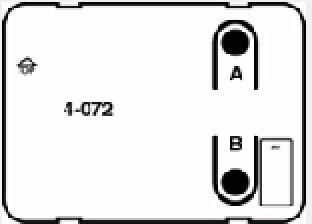

# Button mappings
# 2 buttons switch
1 = A
2 = B
# 4 buttons switch
maps as
3 1
4 2
so
1 = C
2 = D
3 = A
4 = B
# 8 buttons switch
maps as
7 5 3 1
8 6 4 2
so
1 = 2C
2 = 2D
3 = 2A
4 = 2B
5 = 1C
6 = 1D
7 = 1A
8 = 1B
Above example 14E7F4:3 would give:
- for 4 buttons switch - push button A,
- for 8 buttons switch - push button 2A.
