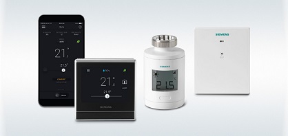

The Siemens RDS binding provides the infrastructure for connecting openHAB to the Siemens Climatix IC cloud server and integrate connected Siemens RDS Smart thermostats (opens new window) onto the openHAB bus.
# Supported Things
The binding supports two types of Thing as follows..
| Thing Type | Description |
| Climatix IC Account | User account on the Siemens Climatix IC cloud server (bridge) to connect with respective Smart Thermostat Things below.. |
| RDS Smart Thermostat | Siemens RDS model Smart Thermostat devices |
