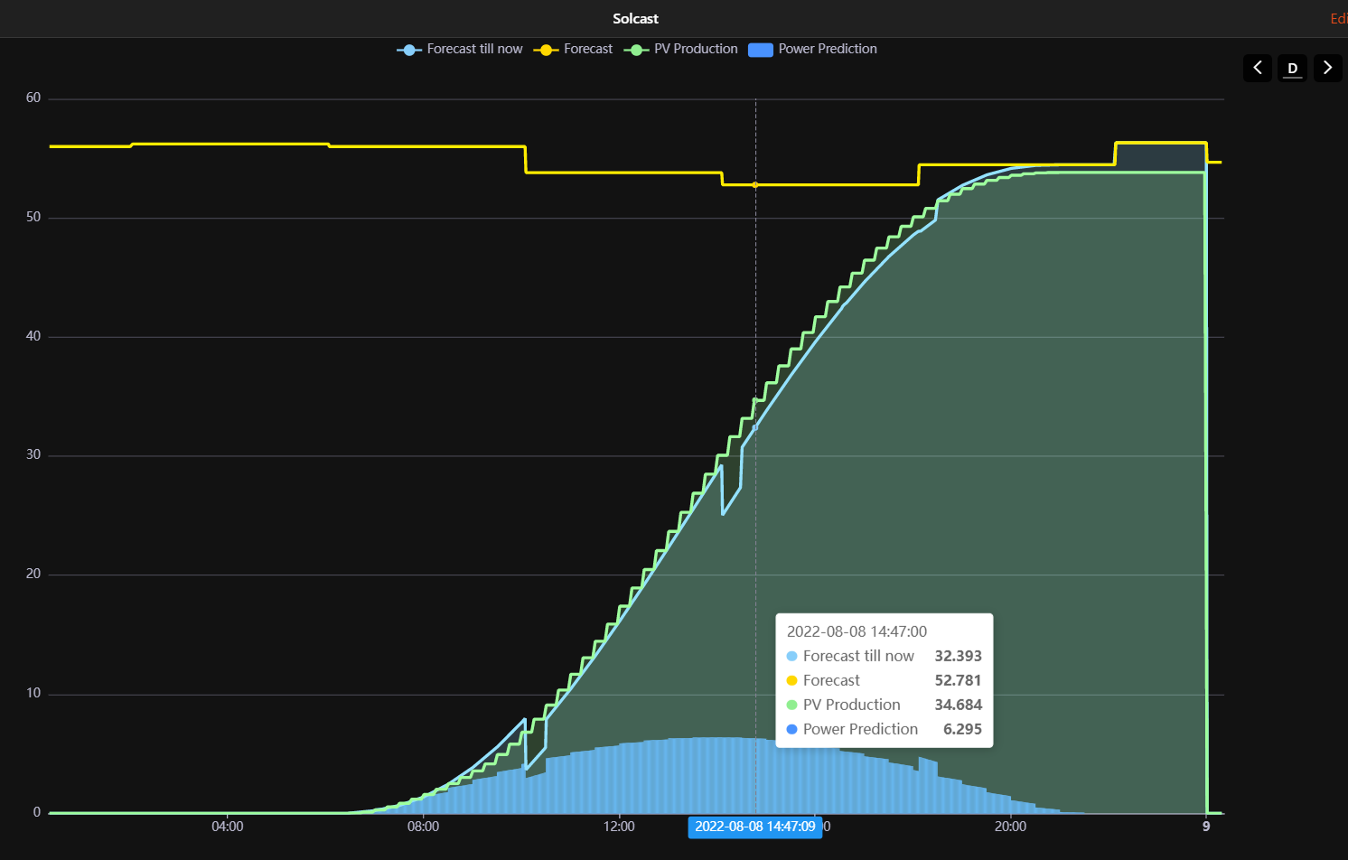

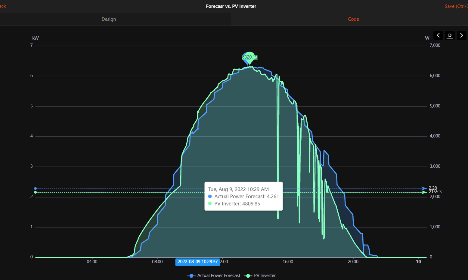

Display Power values of Forecast and PV Inverter items
Display Energy values of Forecast and PV inverter items Yellow line shows Daily Total Forecast.
