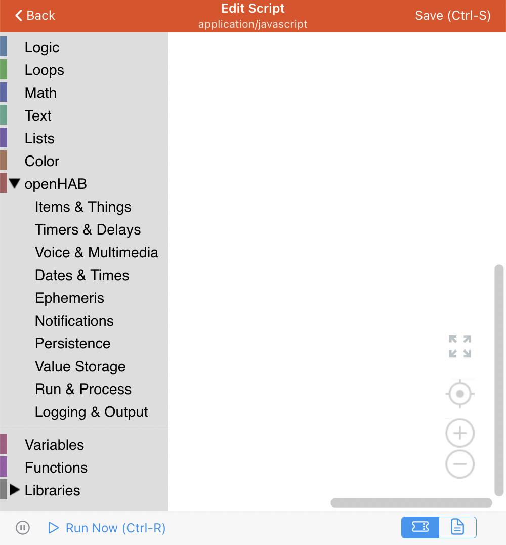

und you should now see this screen
- you can now click the
to access all openHAB Blocks.
- Drag and Drop the blocks to the white area

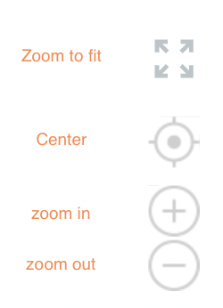

You can move around Blockly's workspace by clicking and dragging on the empty space, or by using two fingers on a touch screen or a trackpad.
Zooming can be done using either of these methods:
By pinching or stretching on a touch screen or a trackpad.
By holding Ctrl while dragging or moving with two fingers on the touch screen or trackpad.
With the on-screen controls:

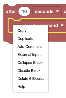

A context menu is available when right-clicking on a block.
Right-clicking on an empty area in the workspace will pop up a slightly different context menu.

# Other Operations
Duplicate: Clones the block
Add comment: Adds a comment to the block
Inline Inputs / External inputs: Switches between horizontal or vertical alignment of inputs
Inline:
External:

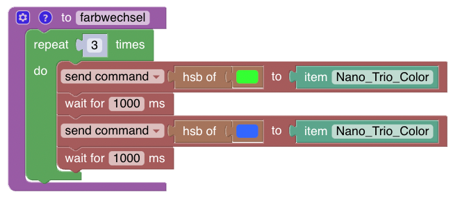

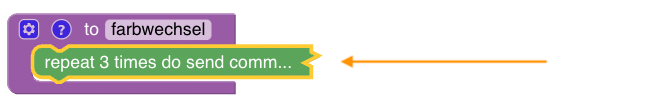

Collapse (expand) block: Shrinks the block to get a better overview
Normal block view:
Collapsed view:
Disable (enable) block: Disables the block, so no code is generated and its functionality switched off
Delete: delete the blocks (this can be reverted via Command/Ctrl-Z)

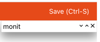

Sometimes blockly rules become pretty big, and it is hard to find particular blocks in the rule. Therefore, a search functionality has been provided by pressing Cmd/Ctrl-F which opens a small search window in the top right (just below the "save"-label). After pressing Enter all found blocks that contain the search term are marked in black.
