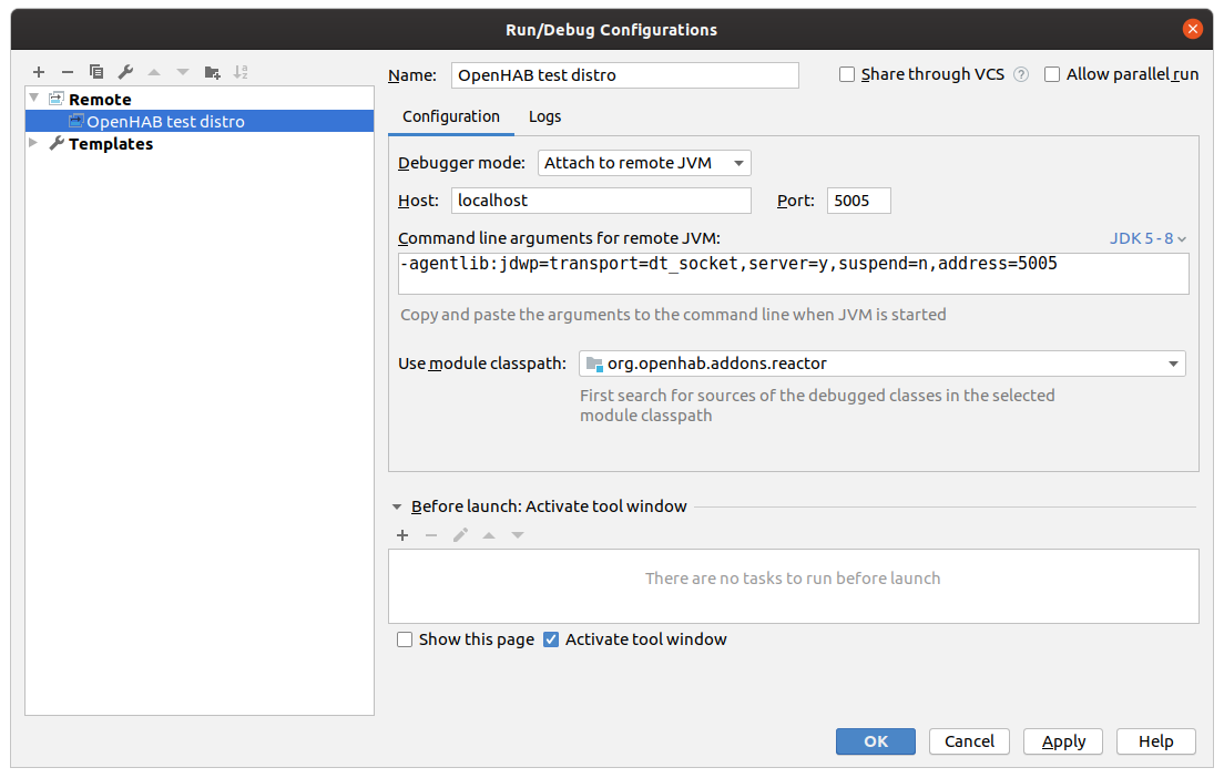

Create a Remote Debug runtime configuration in IntelliJ:
- open menu Run | Edit configurations
- click the + sign to add a "Remote" configuration
- adapt the module setting to the root (org.openhab.addons.reactor)
- click OK
- start the debug configuration
- the IntelliJ console should log:
Connected to the target VM, address: 'localhost:5005', transport: 'socket'
You can now add breakpoints to your project now and your test distro should stop there.
