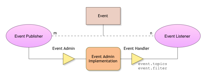

The Event Admin Service (org.osgi.service.event.EventAdmin) takes a central place in the communication between Event Publishers and subscribers (Event Listeners).
It is responsible for keeping track of the listeners, and sending events to them.
It supports both synchronous and asynchronous sending that will be reviewed in more details in the section about sending events.
But let's illustrate that with the following picture:
Fig.1 Event Admin Service (Source: https://enroute.osgi.org/img/services/org.osgi.service.event.overview.png (opens new window))
