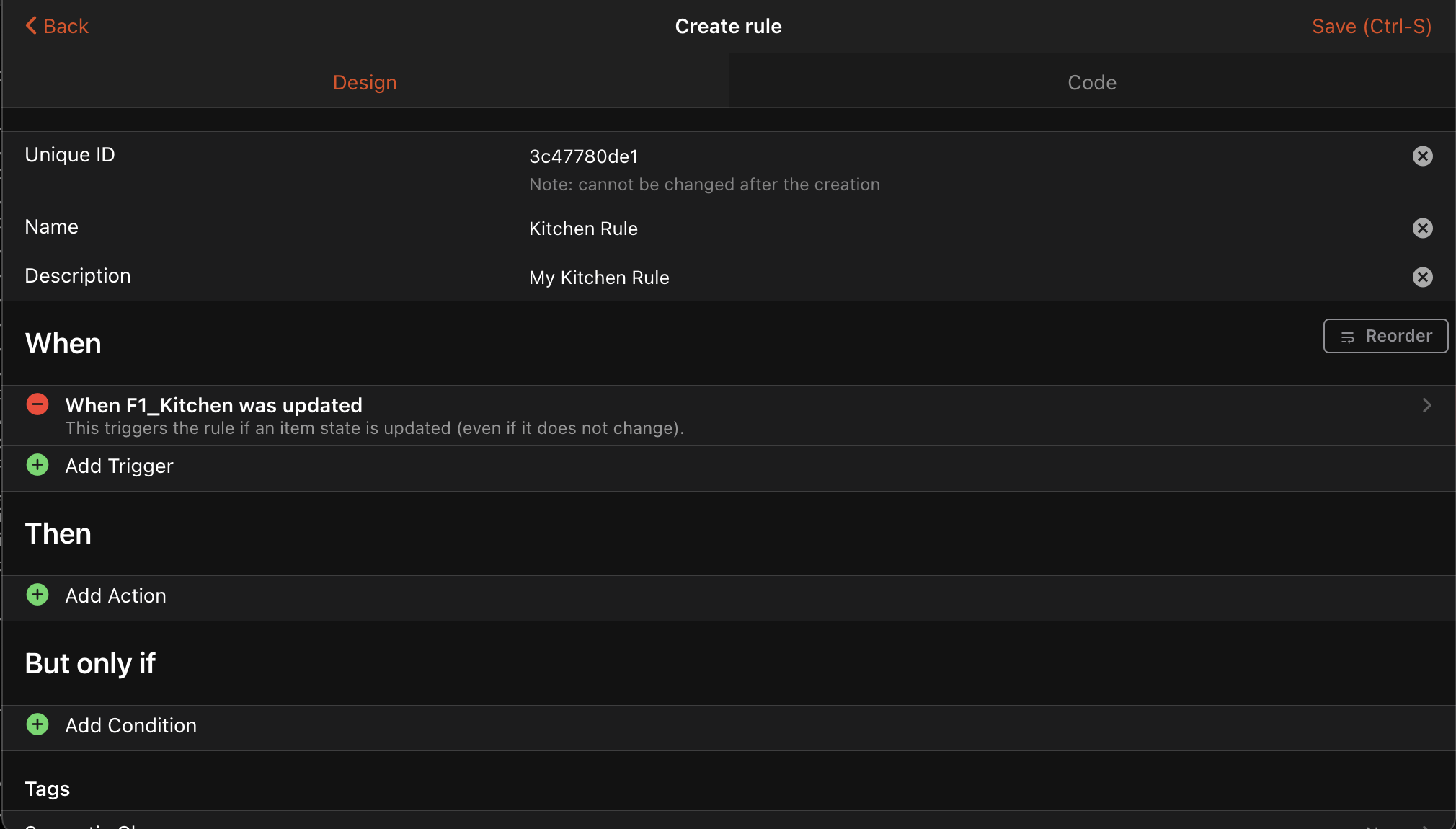

# Adding Triggers
Using the openHAB UI, first create a new rule and set a trigger condition.

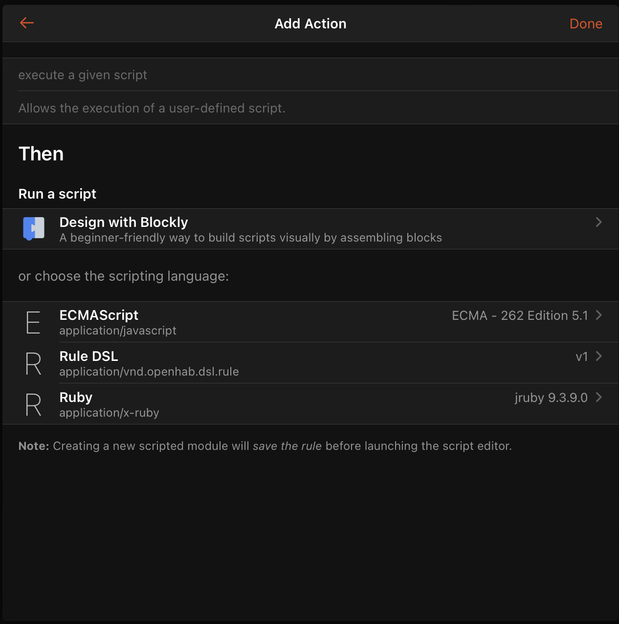

# Adding Actions

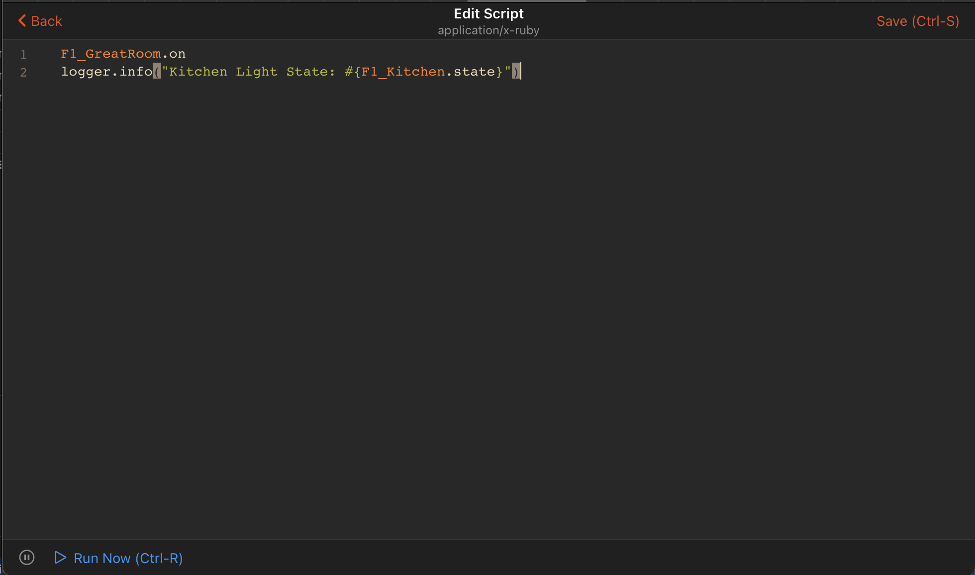

Select "Add Action" and then select "Run Script" with "Ruby". This will bring up an empty script editor where you can enter your JavaScript.
You can now write rules using standard Ruby along with the included openHAB library.
For example, turning a light on:
KitchenLight.on
logger.info("Kitchen Light State: #{KitchenLight.state}")
Sending a notification:
Notification.send("[email protected]", "Balcony door is open")
Querying the status of a thing:
logger.info("Thing status: #{things["zwave:serial_zstick:512"].status}")"
Theoretically you could even use a system start trigger with a UI rule, and then use the syntax mostly developed for file based rules to create multiple rules.
