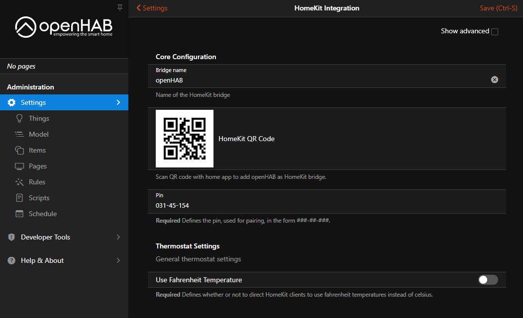

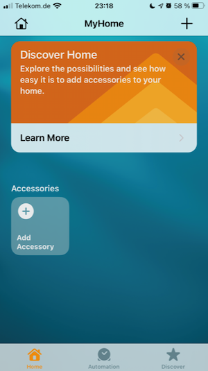

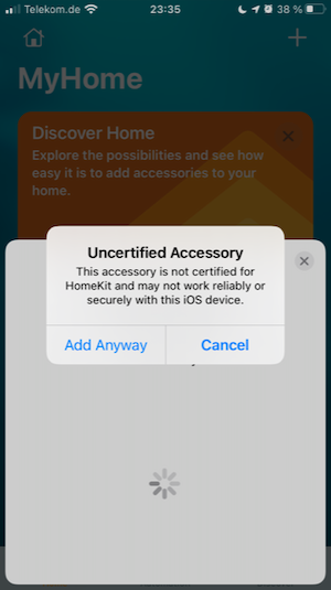

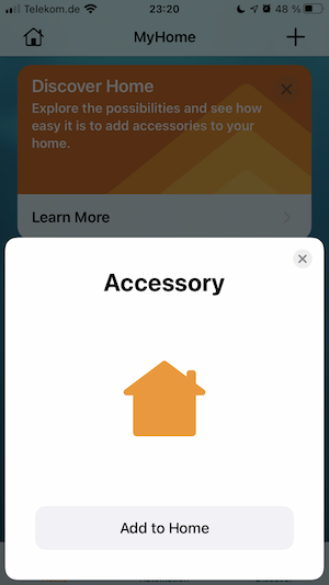

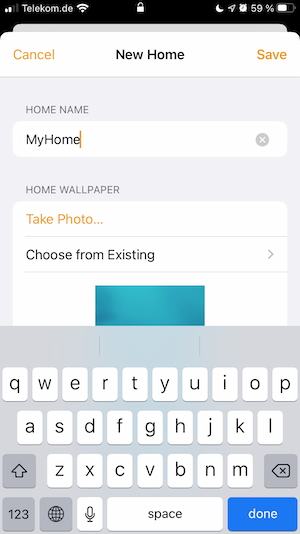

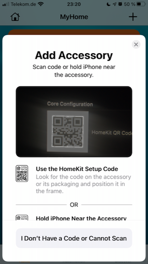

# Quick start
  • install homekit addon via UI
  • add metadata to an existing item (see UI based configuration)
  • scan QR code from UI->Settings->HomeKit Integration
  • open Home app on your iPhone or iPad
  • create new home
  • add accessory
  • scan QR code from UI->Setting-HomeKit Integration
  • click "Add Anyway"
  • follow the instruction of the Home app wizard
Add metadata to more items or fine-tune your configuration using further settings
# Global Configuration
You can define HomeKit settings either via mainUI or via $OPENHAB_CONF/services/homekit.cfg. HomeKit works with default settings, but we recommend changing the pin for the bridge. This will be used in iOS when pairing without QR Code. The pin code is in the form "###-##-###". Requirements beyond this are not clear, and Apple enforces limitations on eligible pins within iOS. At the very least, you cannot use repeating (111-11-111) or sequential (123-45-678) pin codes.
Other settings, such as using Fahrenheit temperatures and specifying the interface to advertise the HomeKit bridge are also illustrated in the following sample:
org.openhab.homekit:port=9123
org.openhab.homekit:pin=031-45-154
org.openhab.homekit:useFahrenheitTemperature=true
org.openhab.homekit:networkInterface=192.168.0.6
org.openhab.homekit:useOHmDNS=false
org.openhab.homekit:blockUserDeletion=false
org.openhab.homekit:name=openHAB
org.openhab.homekit:instances=1
org.openhab.homekit:useDummyAccessories=false
Some settings are only visible in UI if the checkbox "Show advanced" is activated.

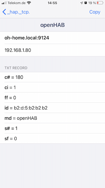

networkInterface IP address or domain name under which the HomeKit bridge can be reached. If no value is configured, the add-on uses the primary IP address configured for openHAB. If unsure, keep it empty (none)
port Port under which the HomeKit bridge can be reached. 9123
useOHmDNS mDNS service is used to advertise openHAB as HomeKit bridge in the network so that HomeKit clients can find it. openHAB has already mDNS service running. This option defines whether the mDNS service of openHAB or a separate service should be used. false

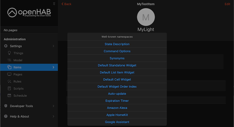

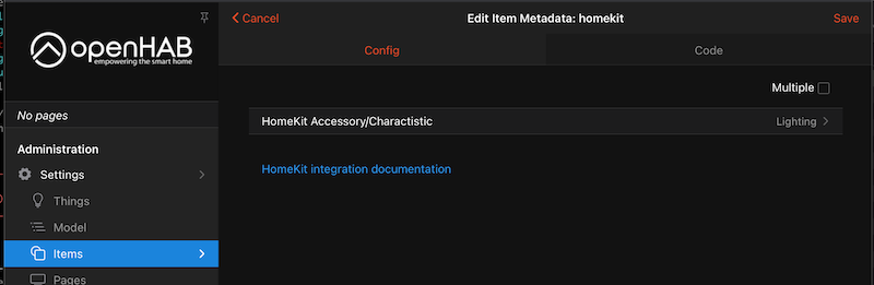

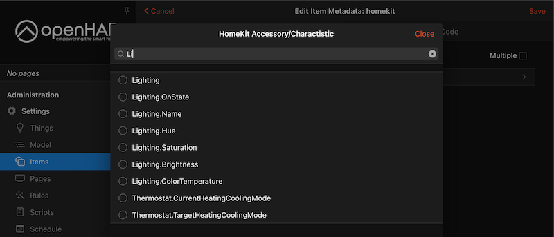

# UI based Configuration

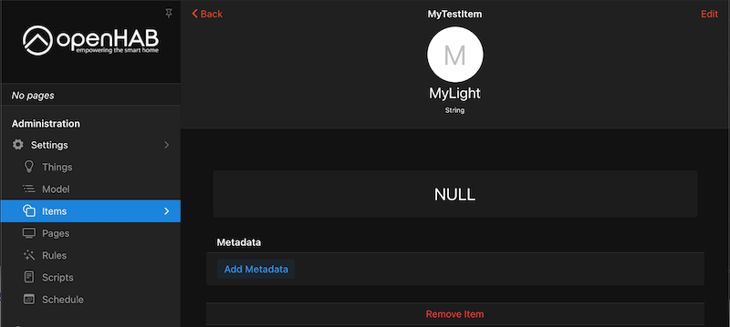

In order to add metadata to an item:
  • select desired item in mainUI
  • click on "Add Metadata"
  • select "Apple HomeKit" namespace
  • click on "HomeKit Accessory/Characteristic"
  • select required HomeKit accessory type or characteristic
  • click on "Save"

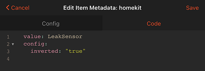

# Textual configuration
Switch leaksensor_metadata  "Leak Sensor"           {homekit="LeakSensor"}
The tag can be:
  • full qualified: i.e. with accessory type and characteristic, e.g. "LeakSensor.LeakDetectedState"
  • shorthand version: with only either accessory type or characteristic, e.g. "LeakSensor", "LeakDetectedState".
if shorthand version has only accessory type, then HomeKit will automatically link all mandatory characteristics of this accessory type to the openHAB item. e.g. HomeKit window covering has 3 mandatory characteristics: CurrentPosition, TargetPosition, PositionState. Following are equal configuration:

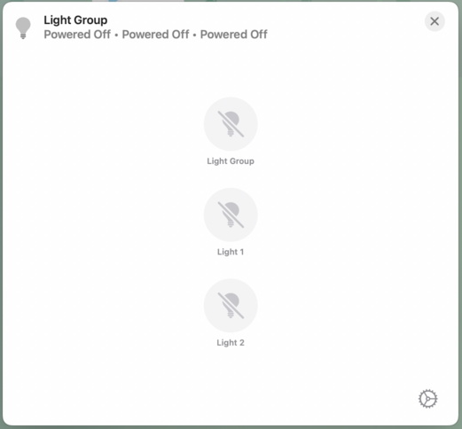

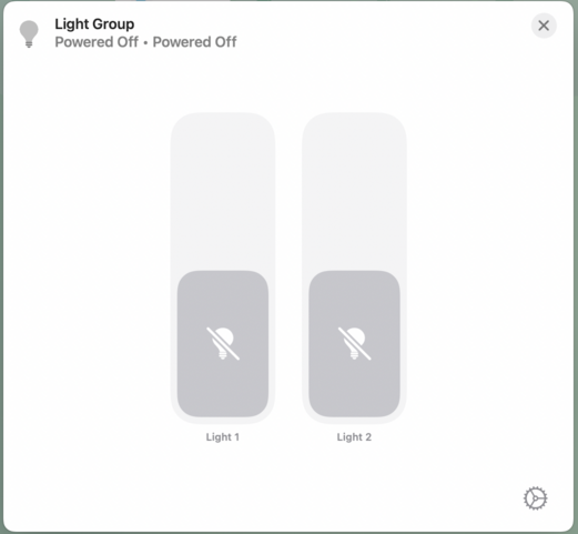

Alternatively, you may want to have a choice of controlling the items individually, OR as a group, from HomeKit. The following examples defines a single HomeKit accessory with multiple services that the Home app will allow you to control together, or drill down and control individually. Note that AccessoryGroup doesn't expose any services itself, but allows you to group other services together underneath it. Also note that when nesting accessories, you cannot use the shorthand of naming only a characteristic, and not its accessory type, since it would be ambiguous if that item belongs to a secondary service, or to the primary service it's nested under.
Group:Switch:OR(ON,OFF) gLight "Light Group" {homekit="AccessoryGroup"}
Switch light1 "Light 1" (gLight) {homekit="Lighting"}
Switch light2 "Light 2" (gLight) {homekit="Lighting"}
Group of Lights

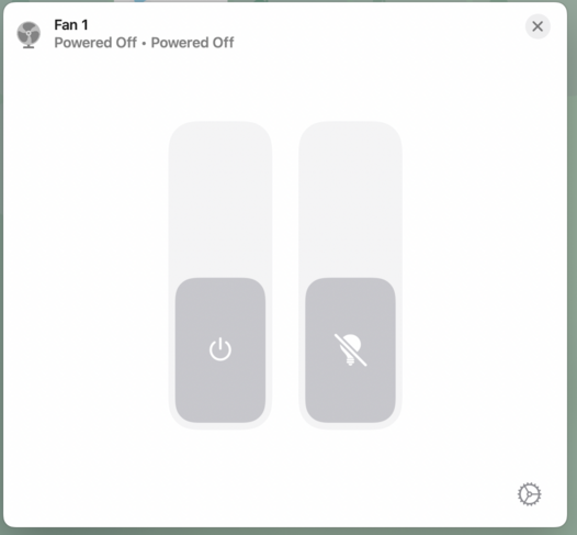

You can also mix and match accessories:
Group gFan {homekit="Fan"}
Switch fan1 "Fan" (gFan) {homekit="Fan.Active"}
Switch fan1_light "Fan Light" (gFan) {homekit="Lighting"}
Fan With Light

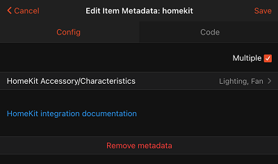

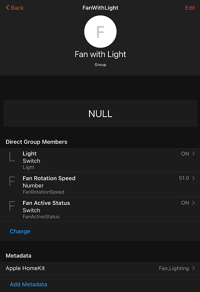

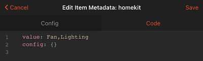

Another way to build complex accessories is to associate multiple accessory types with the root group, and then define all of the individual characteristics on group members. When using this style, you cannot have multiple instance of the same accessory type.
Group           FanWithLight        "Fan with Light"                           {homekit = "Fan,Lighting"}
Switch          FanActiveStatus     "Fan Active Status"     (FanWithLight)     {homekit = "Fan.ActiveStatus"}
Number          FanRotationSpeed    "Fan Rotation Speed"    (FanWithLight)     {homekit = "Fan.RotationSpeed"}
Switch          Light               "Light"                 (FanWithLight)     {homekit = "Lighting.OnState"}
or in MainUI:
ui_fan_with_light_group_view.png ui_fan_with_light_group_code.png ui_fan_with_light_group_config.png

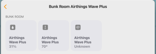

You can even form complex sensors this way. Just be sure that you fully specify additional characteristics, so that the addon knows which root service to add it to.
Group eBunkAirthings "Bunk Room Airthings Wave Plus" { homekit="AirQualitySensor,TemperatureSensor,HumiditySensor" }
String Bunk_AirQuality "Bunk Room Air Quality" (eBunkAirthings) { homekit="AirQualitySensor.AirQuality" }
Number:Dimensionless Bunk_Humidity "Bunk Room Relative Humidity [%d %%]" (eBunkAirthings) { homekit="HumiditySensor.RelativeHumidity" }
Number:Temperature Bunk_AmbTemp "Bunk Room Temperature [%.1f °F]" (eBunkAirthings) { homekit="TemperatureSensor.CurrentTemperature" }
Number:Dimensionless Bunk_tVOC "Bunk Room tVOC [%d ppb]" (eBunkAirthings)  { homekit="AirQualitySensor.VOCDensity" [ maxValue=10000 ] }

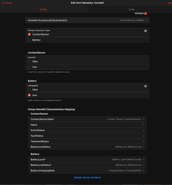

A sensor with a battery configured in MainUI:

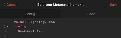

The Home app uses the first accessory in a group as the icon for the group as a whole. E.g. an accessory defined as homekit="Fan,Light" will be shown as a fan and an accessory defined as homekit="Light,Fan" will be shown as a light in the Home app. You can also override the primary service by using adding primary=<type> to the HomeKit metadata configuration:
Group           FanWithLight        "Fan with Light"                           {homekit = "Light,Fan" [primary = "Fan"]}
on in MainUI:

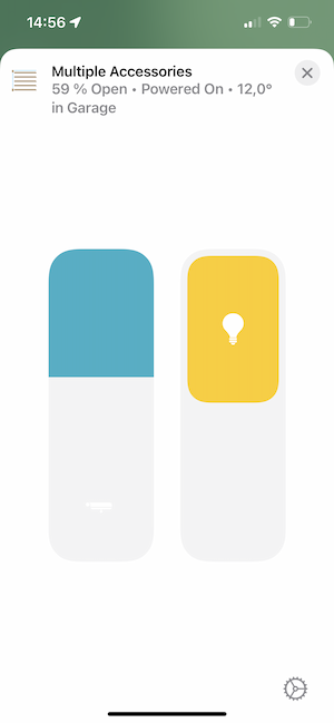

Unusual combinations are also possible, e.g. you can combine temperature sensor with blinds and light.
It will be represented by the Home app as follows:
Note that for sensors that aren't interactive, the Home app will show the constituent pieces in the room and home summaries, and you'll only be able to see the combined accessory when viewing the accessories associated with a particular bridge in the home settings:
Triple Air Sensor Triple Air Sensor Broken Out

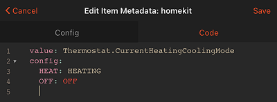

# Thermostat modes
HomeKit thermostat supports following modes
  • CurrentHeatingCoolingMode: OFF, HEAT, COOL
  • TargetHeatingCoolingMode: OFF, HEAT, COOL, AUTO
These modes are mapped to string values of openHAB items using configuration at the item level. e.g. if your current mode item can have following values: "OFF", "HEATING", "COOLING" then you need following mapping at item level
String          thermostat_current_mode     "Thermostat Current Mode" (gThermostat) {homekit = "CurrentHeatingCoolingMode" [OFF="OFF", HEAT="HEATING", COOL="COOLING"]}
You can provide mapping for target mode in a similar way.
The custom mapping can be also used to reduce number of modes shown in Home app. The modes can be only reduced, but not added, i.e. it is not possible to add a new custom mode to HomeKit thermostat.
Example: if your thermostat does not support cooling, then you need to limit mapping to OFF and HEAT values only:
String          thermostat_current_mode    "Thermostat Current Mode"            (gThermostat) {homekit = "CurrentHeatingCoolingMode" [HEAT="HEATING", OFF="OFF"]}
String          thermostat_target_mode     "Thermostat Target Mode"             (gThermostat) {homekit = "TargetHeatingCoolingMode" [HEAT="HEATING", OFF="OFF"]}
The mapping using main UI looks like following:

Switch and Contact items support inversion of the state mapping, e.g. by default the openHAB switch state "ON" is mapped to HomeKit contact sensor state "Open", and "OFF" to "Closed". The configuration "inverted=true" inverts this mapping, so that "ON" will be mapped to "Closed" and "OFF" to "Open".
Examples of sensor definitions. Sensors without optional characteristics:
Switch  leaksensor_single    "Leak Sensor"                   {homekit="LeakSensor"}
Number  light_sensor         "Light Sensor"                  {homekit="LightSensor"}
Number  temperature_sensor   "Temperature Sensor [%.1f °C]"  {homekit="TemperatureSensor"}
Contact contact_sensor       "Contact Sensor"                {homekit="ContactSensor"}
Contact contact_sensor       "Contact Sensor"                {homekit="ContactSensor" [inverted=true]}

Sensors with optional characteristics:
Group           gLeakSensor                "Leak Sensor"                                             {homekit="LeakSensor"}
Switch          leaksensor                 "Leak Sensor State"                  (gLeakSensor)        {homekit="LeakDetectedState"}
Switch          leaksensor_bat             "Leak Sensor Battery"                (gLeakSensor)        {homekit="BatteryLowStatus" }
Switch          leaksensor_active          "Leak Sensor Active"                 (gLeakSensor)        {homekit="ActiveStatus" [inverted=true]}
Switch          leaksensor_fault           "Leak Sensor Fault"                  (gLeakSensor)        {homekit="FaultStatus"}
Switch          leaksensor_tampered        "Leak Sensor Tampered"               (gLeakSensor)        {homekit="TamperedStatus"}
Group           gMotionSensor              "Motion Sensor"                                           {homekit="MotionSensor"}
Switch          motionsensor               "Motion Sensor State"                (gMotionSensor)      {homekit="MotionDetectedState"}
Switch          motionsensor_bat           "Motion Sensor Battery"              (gMotionSensor)      {homekit="BatteryLowStatus" [inverted=true]}
Switch          motionsensor_active        "Motion Sensor Active"               (gMotionSensor)      {homekit="ActiveStatus"}
Switch          motionsensor_fault         "Motion Sensor Fault"                (gMotionSensor)      {homekit="FaultStatus"}
Switch          motionsensor_tampered      "Motion Sensor Tampered"             (gMotionSensor)      {homekit="TamperedStatus"}
or using UI

HomeKit listens by default on port 9124. Java prefers the IPv6 network stack by default. If you have connection or detection problems, you can configure Java to prefer the IPv4 network stack instead. To prefer the IPv4 network stack, adapt the Java command line arguments to include: -Djava.net.preferIPv4Stack=true Depending on the openHAB installation method, you should modify start.sh, start_debug.sh, start.bat, or start_debug.bat (standalone/manual installation) or EXTRA_JAVA_OPTS in /etc/default/openhab2 (Debian installation).

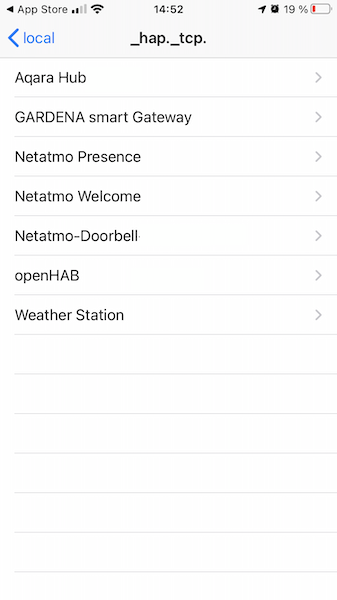

# openHAB is not listed in Home app
if you don't see openHAB in the Home app, probably multicast DNS (mDNS) traffic is not routed correctly from openHAB to Home app device or openHAB is already in paired state. You can verify this with Discovery DNS iOS app (opens new window) as follow:
  • install discovery dns app from app store
  • start discovery app
  • find _hap._tcp in the list of service types
  • if you don't find _hap._tcp on the list, probably the traffic is blocked.
    • to confirm this, check whether you can find _openhab-server._tcp. if you don't see it as well, traffic is blocked. check your network router/firewall settings.
  • if you found _hap._tcp, open it. you should see the name of your openHAB HomeKit bridge (default name is openHAB)
  • if you don't see openHAB bridge name, the traffic is blocked
  • if you see openHAB HomeKit bridge, open it
  • verify the IP address. it must be the IP address of your openHAB server, if not, set the correct IP address using networkInterface settings
  • verify the flag "sf".
    • if sf is equal 1, openHAB is accepting pairing from new iOS device.
    • if sf is equal 0 (as on screenshot), openHAB is already paired and does not accept any new pairing request. you can reset pairing using openhab:homekit clearPairings command in karaf console.
  • if you see openHAB bridge and sf is equal to 1 but you dont see openHAB in the Home app, the Home app probably still thinks it is already paired with openHAB. remove your home from the Home app and restart the iOS device.
