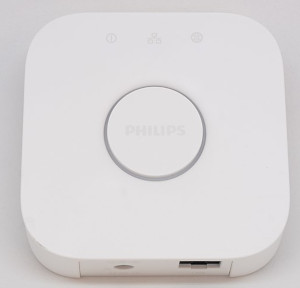

# Discovery
As soon as the service is enabled, it will announce the presence of an (emulated) HUE bridge of the second generation (square bridge). Hue bridges are using the Universal Plug and Play (UPnP) protocol for discovery.
Like the real HUE bridge the service must be put into pairing mode before other applications can access it. By default the pairing mode disables itself after 1 minute (can be configured).

Some Amazon Echo versions only allow V1 Hue bridges (the round ones, not the square ones) to be discovered. If the following option is enabled in combination with the pairing mode, the service will pretend to be an old Hue bridge.
This option resets automatically after pairing mode has been switched off by the timeout.
org.openhab.hueemulation:temporarilyEmulateV1bridge=false
Permanent V1 bridge emulation (no obvious reason to enable that):
org.openhab.hueemulation:permanentV1bridge=false
