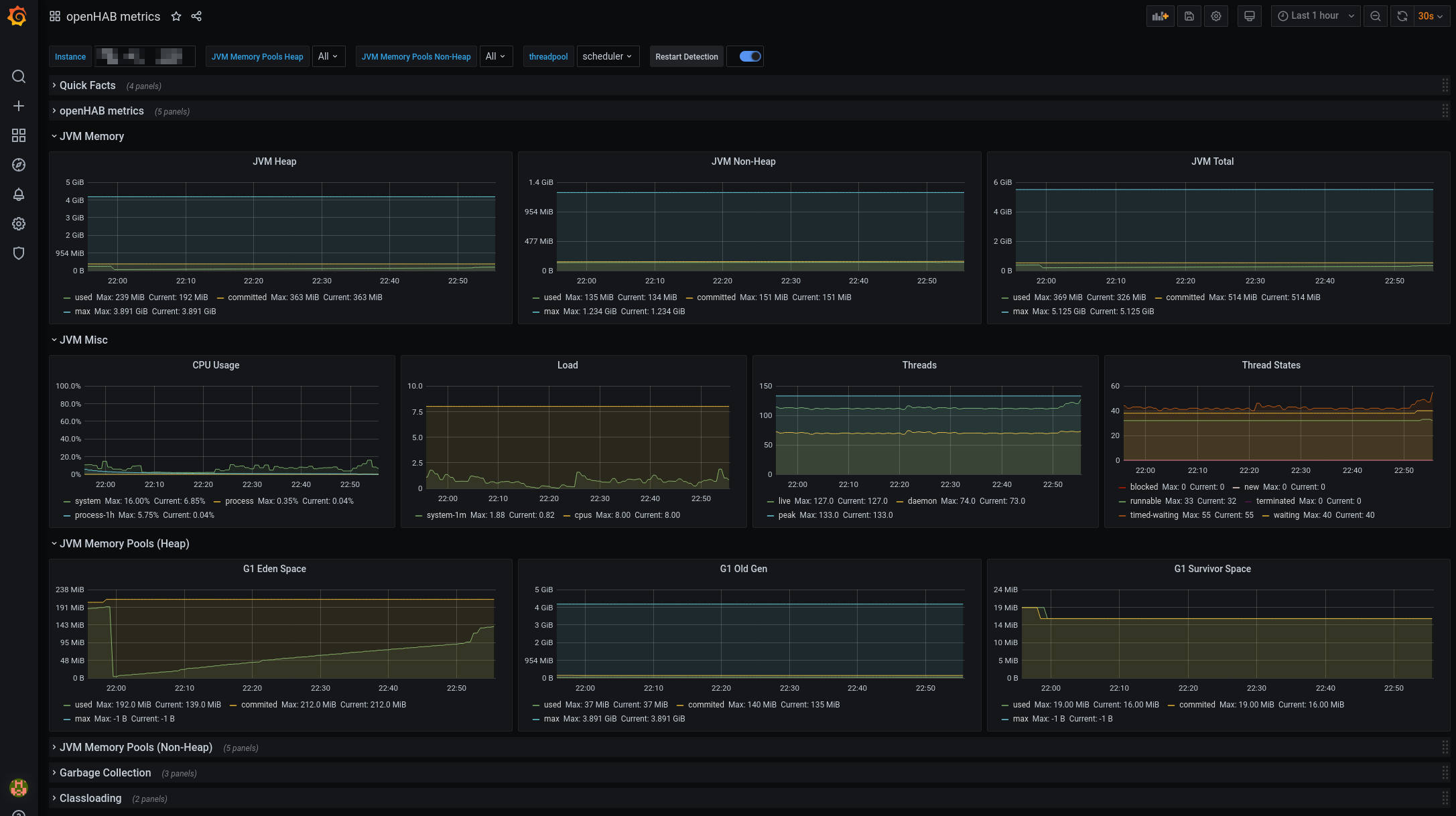

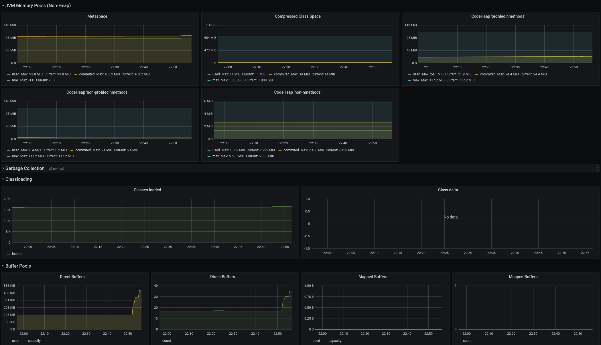

# Grafana
You can now visualize the results in Grafana. Micrometer provides a public Grafana dashboard here (opens new window). I adapted it a little bit to include the openHAB metrics. You can download it here Dashboard. This has been tested with Prometheus - for other monitoring systems adaptions to the dashboard might be necessary.
Here are some screenshots:
