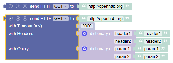

# HTTP Request GET
Function: Send an HTTP GET request to a server and receive the response
The simplest form is shown by default and accepts the destination URI as String.
By activating the toggles the timeout, request headers and query parameters can be provided. Instead of creating a URI containing the query parameters, you can use the query parameter option and provide a Dictionary of query parameters. The provided parameters will automatically be URI encoded.
Here is an example also using a query parameter.

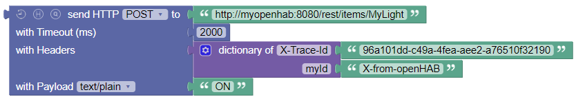

# HTTP Request POST
Function: Send an HTTP POST request to a server and receive the response

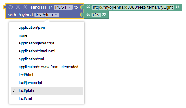

The simplest form is shown by default and accepts the destination URI as String and in comparison to the GET-Request adds a section for the payload which takes two parameters:
- the MIME-type of the content to be sent
- the content to be sent to the destination
For MIME-type application/json you can provide an object as content, and it will be converted to a JSON string.
For application/x-www-form-urlencoded, you can provide a Dictionary and it will be URI encoded.
Here is a more complex example that additionally sets a header and a timeout:

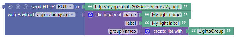

# HTTP Request PUT
Function: Send an HTTP PUT request to a server and receive the response
The simplest form is shown by default and accepts the destination URI as String and is similar in functionality to the POST-Request:
Notice the construction of an object with a Dictionary also containing a List for the JSON payload.
