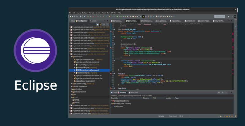

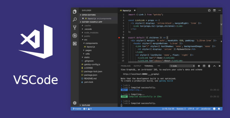

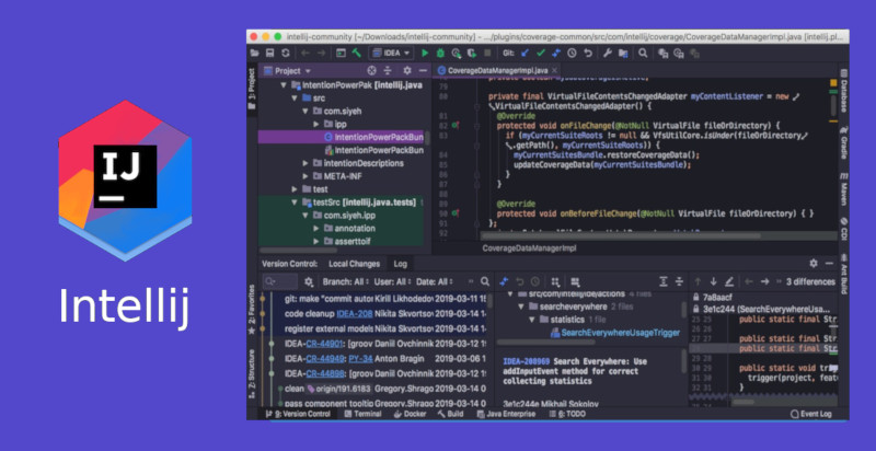

You can use any IDE that is suitable for OSGi/Java development. We have prepared some step-by-step guides for the following IDEs:
Not sure what to choose?: openHAB maintainers use Eclipse IDE (opens new window).
