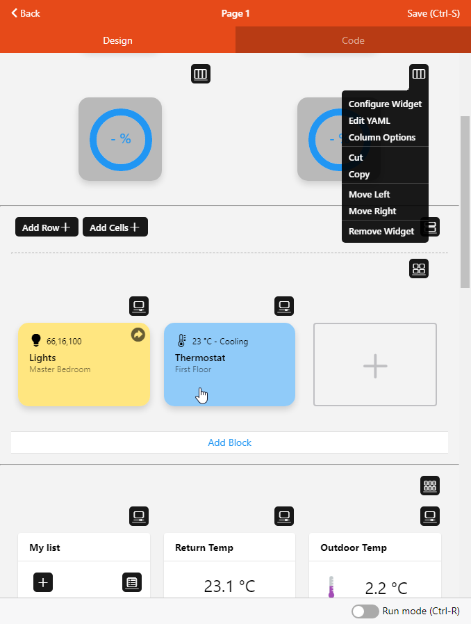

Every type of Page has its own designer but all of them with feature a Design tab and a Code tab.
In the Design tab, you have a view of the Page that easily allows you to add Widgets in various parts. Every designer also has a "general settings" table that will allow you to specify the identifier, the label, as well as some common settings.
You will often find black buttons denoting that the component beside or beneath it can be customized. Some will open menus, that allow to open the configuration sheet for this particular component, reorder them, copy or paste them, remove them, or bring up the part of the YAML structure describing it and its descendents.
In the Code tab, you will be able to alter the component structure of the page, either with the sitemap syntax, or with YAML. In case of YAML, you can trigger autocompletion in many places of the YAML code:
- at the root or component level, hit Ctrl+Space to start a
configsection, aslotssection, or aslotssection with adefaultslot; - at the
configlevel, hit Ctrl+Space before the property name to display a list of properties and add one of them; - at the start of a property's value in
config, hit Ctrl+Space to display a list of options if the property has some (including items).
Some of the designers will also have a Run mode that you can activate with the switch on the bottom toolbar if present, or the Ctrl+R keyboard shortcut. It will allow you to preview the page as it would be rendered (some actions will still not work in Run mode).
