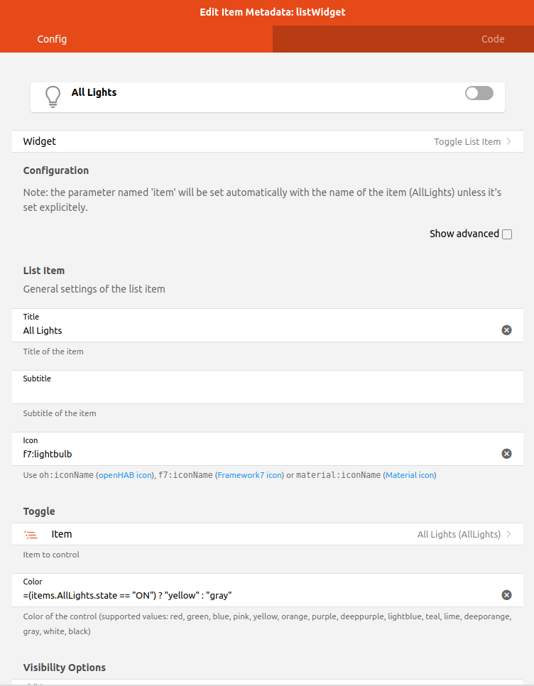

As you are learning how widgets work and all of the available options, it might be easier to create the widget using the form presented when adding the Item metadata and then copying the YAML from the code tab to the Custom Widget editor. When doing this make sure to fill out all the fields, because when using the defaults no value is added to the YAML in the code tab. So, for example, be sure to enter in the Item field.
Here is a filled-out form customizing a list Item widget for a light.
light list item widget form
Clicking on the code tab shows the following YAML.

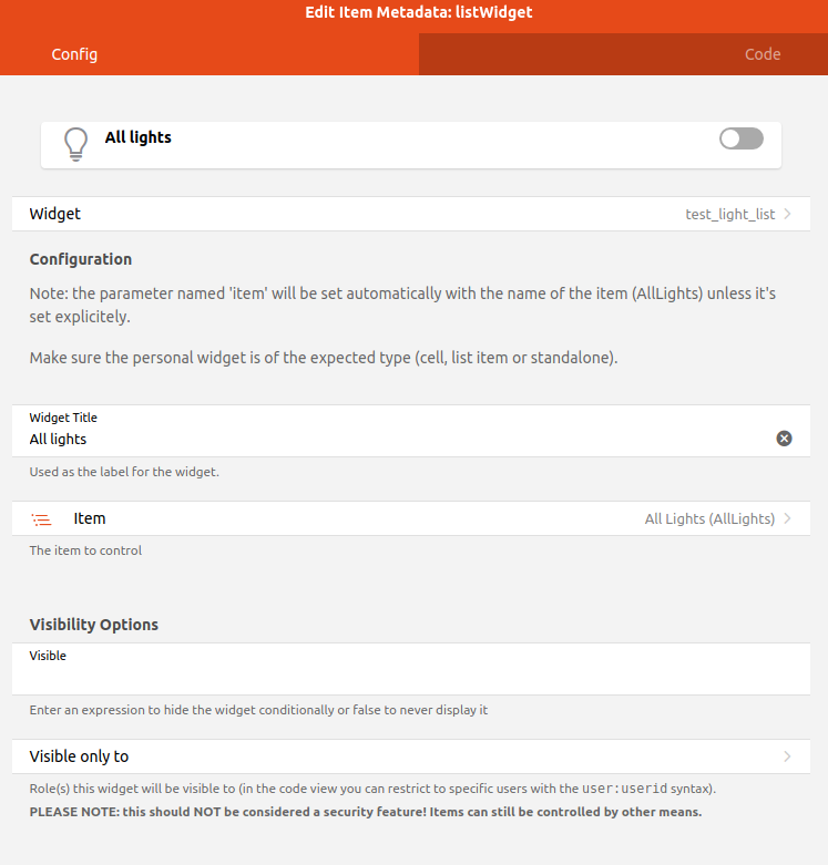

Save the widget and return to one of the Items that should use this widget. Select "test_light_list" as the widget type and you will be presented with a form to enter the title and select the Item.
applying custom list widget
Whenever a custom widget is changed, every Item that uses that custom widget will be updated with the change. This is a powerful tool to create and maintain the look and feel of your UIs.

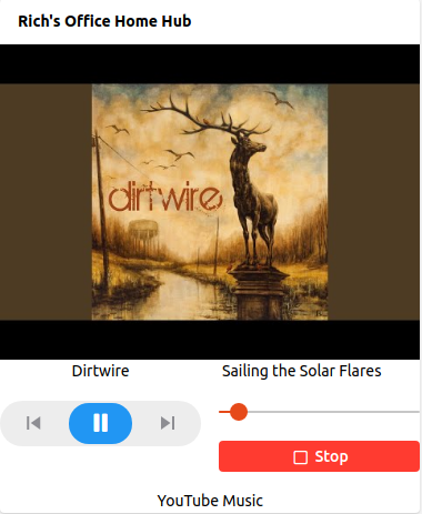

This is a widget to represent a Chromecast.
Chromecast widget

A full explanation of the widget is outside the scope of this tutorial, but there are a few key take-aways. As with the list widget, it might be easier to create the widget on the Page editor first and then copy that to the custom widget as described above. First notice that not all the components used start with "oh". When building a complicated custom widget, one has more flexibility when using the base "f7" widgets instead.
Notice how the only property related to Items is a prefix. If one is consistent in their Item naming, one can define a prefix and the widget can build the Item names for each relevant Item using the prefix. This can greatly simplify the configuration of a widget. In this case the widget uses seven different Items that can all be obtained from that one property.

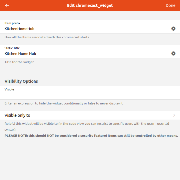

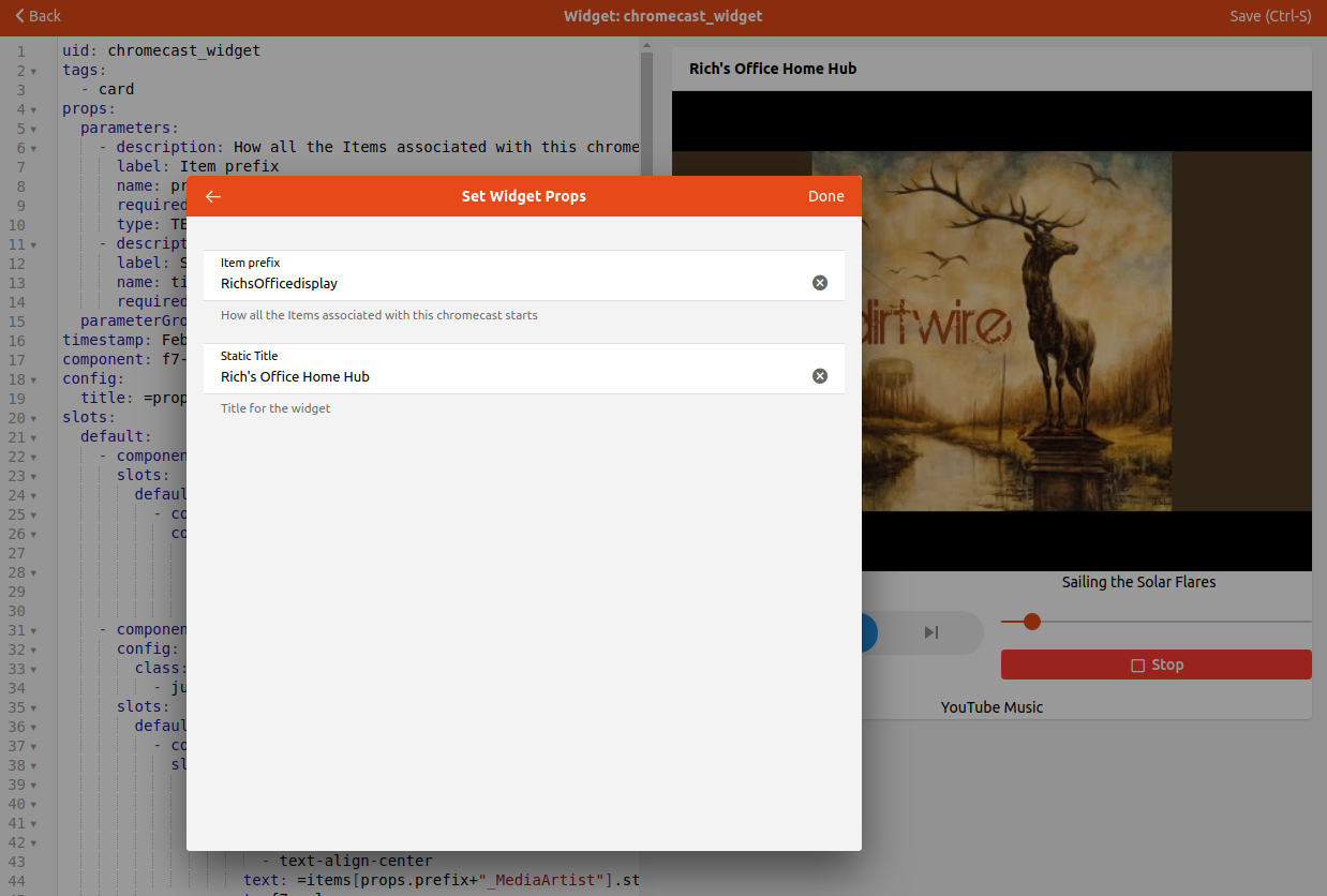

As you create a widget that uses properties, you will notice that the preview does not get rendered correctly.
Chromecast widget no props
At the bottom of the widget editor there is a "Set Props" option, which can also be accessed by typing CTRL-p. This will bring up a form where the props can be set for the preview.
Chromecast widget props set
Once created, apply the custom widget to the Equipment Group Item in the model by selecting it as the default stand-alone widget.

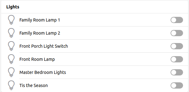

It is also possible to create widgets that are dynamically populated from the model. This is particularly useful to present a functional widget, such as one widget to control all the lights in the house. For this, the oh-repeater component is very useful. This component allows one to set up a loop to iterate over a bunch of things, such as all the Items with a given semantic properties tag, and create a widget element for each one.
For example, here is a widget that shows all the Items with a Switch and Light tag, filtering out those that have "Christmas" in the name unless the TisTheSeason Switch is ON.
all lights widget

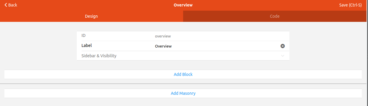

Now that the widgets are created, it's time to put them on a Page. We will focus on the Overview tab of the Overview page.
To edit any Page go to Settings -> Pages in MainUI. There will be a grayed-out entry which represents the customized Locations, Equipment, and Properties tabs, and there will be an Overview entry. That entry represents the Overview tab. Clicking on it will bring up a configuration page that allows you to configure the Overview tab with your custom widgets. You can build the widgets here, but it's more flexible to create custom widgets and add them to this page.
A full description on how to build the page is beyond the scope of this tutorial. See the Layout Pages docs for details.
You will be presented with a page similar to the following.
blank overview
Because this is the first thing your users will see when accessing openHAB, the most commonly use actuators and widgets should be on this page.

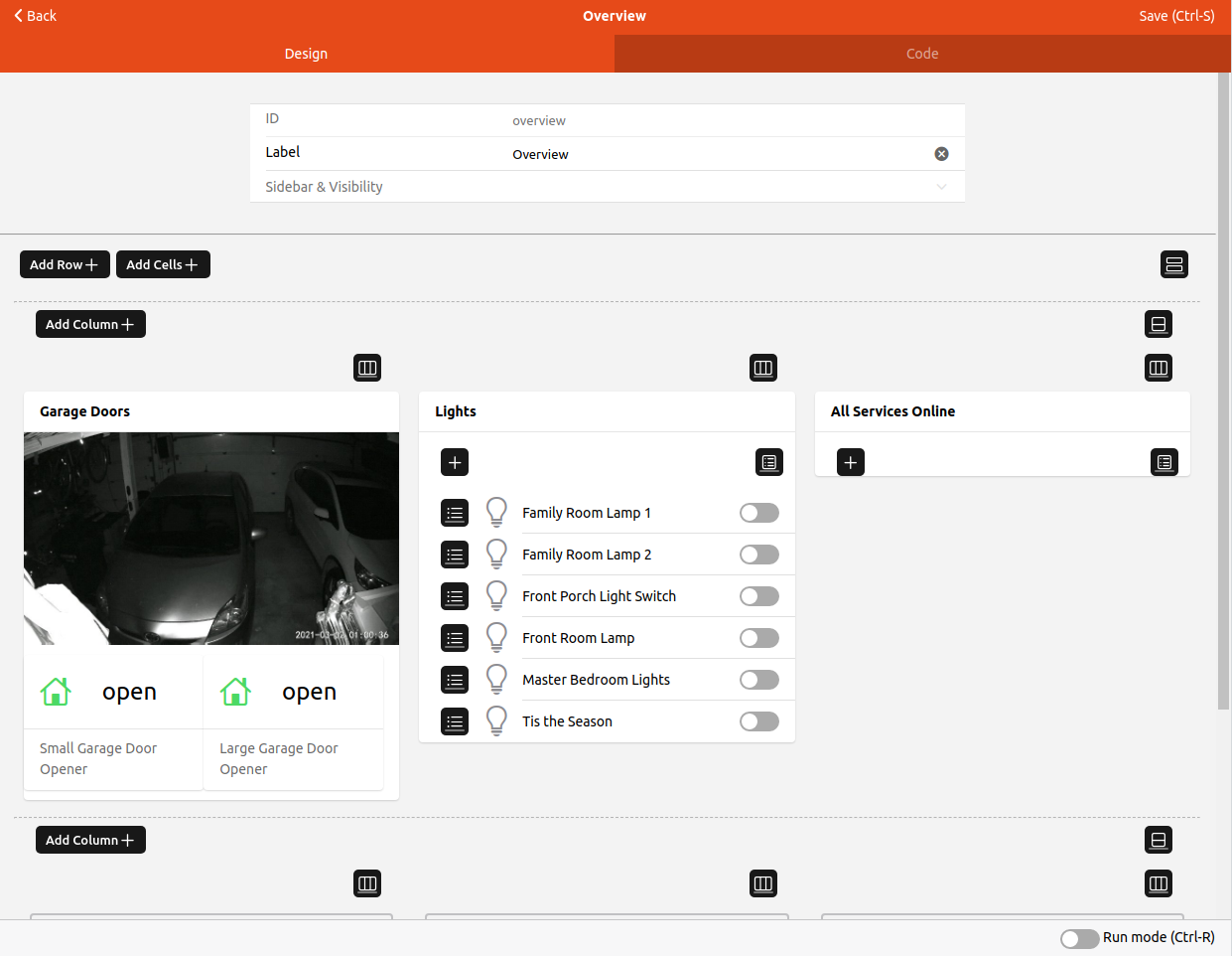

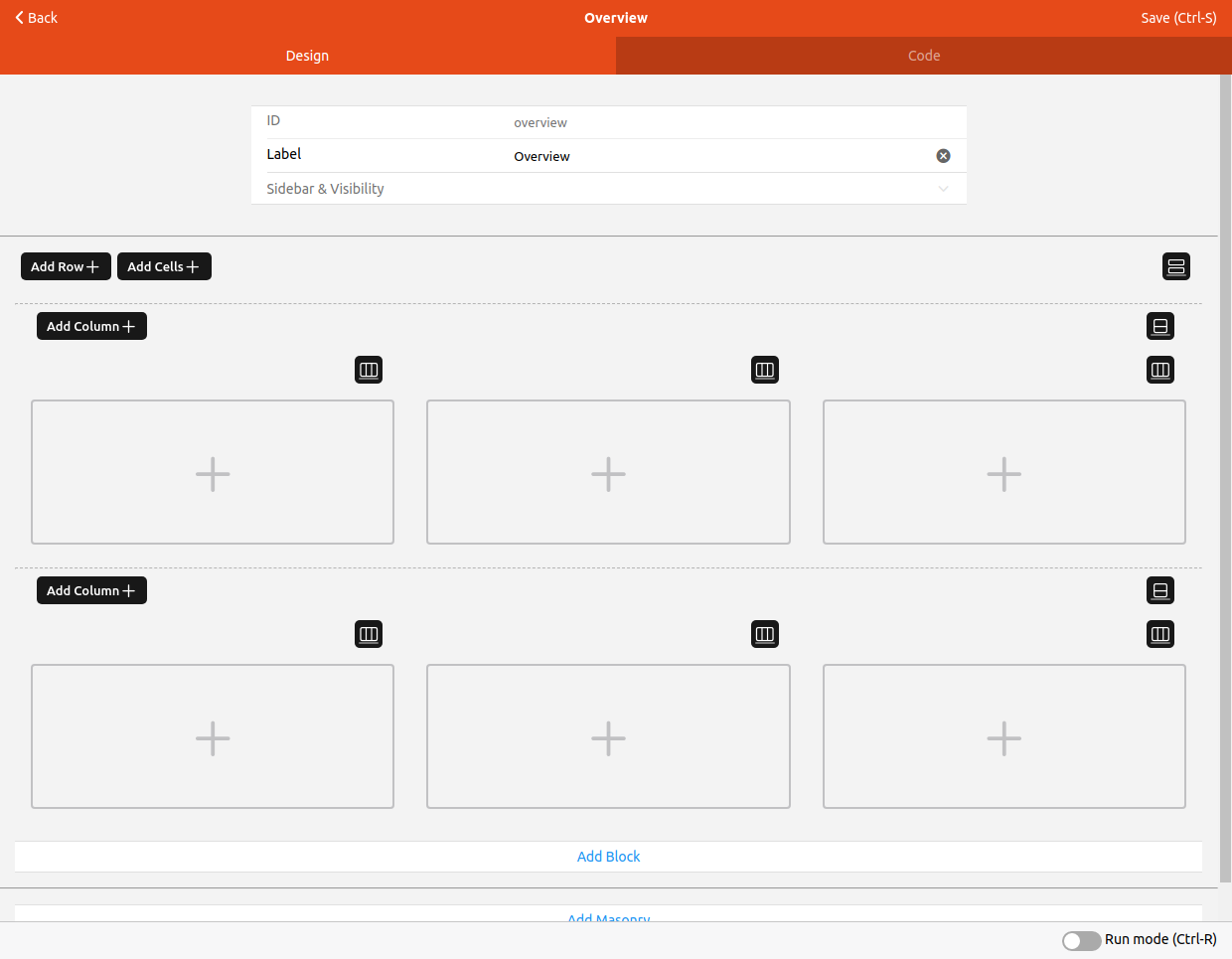

To get started, click "Add Block", then "Add Row" and finally add however many columns you want. Repeat for additional rows. For this tutorial we will have two rows and three columns.
Overview row and columns
Now we will add a custom widget to that first column. In this case we will add a garage door widget that includes a camera feed, shows the door status, and allows triggering two garage doors. Click on the + in that first cell and select the desired widget from the list. This is a simple widget that doesn't use any properties, so we are done.
Next we'll add the all lights widget from above. Click on the second cell and select the desired widget from the list. This is a dynamic widget, but also doesn't have any properties, so we are done with it.
Finally we will add a services status widget which shows any home automation related devices or services that are offline. This one is also a dynamic widget without properties. The Page currently looks as follows.
Overview row one populates

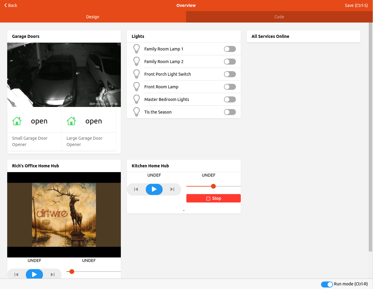

Now we will fill out the bottom row with some widgets from the model. The Chromecast widget was applied to all the Chromecast Equipment Group Items as the default stand-along widget. Click on the first cell in the second row and this time select "Add from Model". Navigate to the Equipment Item desired and "Pick" it.
Alternativly, you can select the custom widget from the list and set the properties instead of adding from the model. When you add the widget this way, the widget will look just like it does in the preview when the properties are not yet set. To set the properties here, click on the edit icon and select "Configure Widget". You will be presented with a form to enter the values for the properties, in this case the Item prefix and title.
Kitchen Chromecast Widget Props
To preview the configuration in progress there is a toggle at the bottom of the page for "Run mode", or you can press CTRL-R.
Overview preview
Once you are happy, save the page and that will become your Overview page.

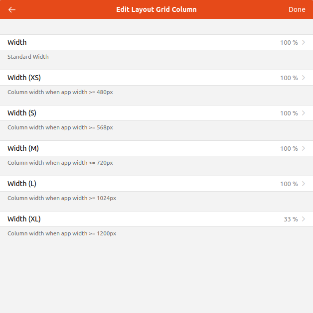

# Responsive Pages
The Page will be viewed on a variety of screen sizes, from computers to tablets to phones. To make the page adapt to the different screen widths there is a "Column Options" option in a given column's setting icon.
Column Settings
This lets you define what percentage of a row a given column takes up based on the size of the screen the Page is being displayed on. The above configuration is set for all the columns, and consequently each card will take up the full width of the screen unless it is a very wide screen (e.g. a computer screen).
